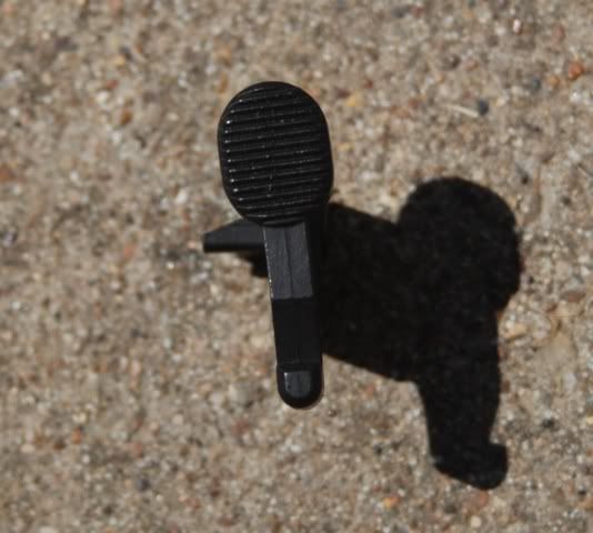

  • I bought a LPK from M1S. That was a mistake. The bolt catch was crooked.
    They replaced it, but you'd better believe any future LPKs will NOT be coming from M1S.
      That's about how some of the hammer and triggers were on the ones I sent back. It appeared they were bent somehow after the forging process. I post some pics after I get them to photobucket.

      • Trigger holes not lined up preventing pin from going through.
        2 Triggeres & Hammer. Notice hammer hole off center
        Hammer Notice hole housing on right appears to be bent, plus the OD of the housing on right is smaller than that on the left.
        Hammer

        • Holy cow! Who made/sold those?

          • Originally posted by jwise View Post
            I won't publicly say who sold them since they issued a full refund immediately upon receipt. The forge stampings were 'S'. But I see that on a lot of them, so that may or may not tell who made them. Could be the seller bought in bulk and unwittingly ended up with a bunch of garbage.
